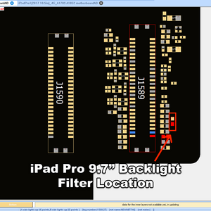

iPad Pro 9.7” powers on and displays an image that is only visible under a flashlight, indicating no backlight. The device otherwise functions normally (touch, sound, boot).
This issue is commonly caused by a blown backlight filter, most frequently FL1728.
It often occurs when a new display is connected while the battery is still plugged in, causing a current surge that damages the filter.
iPad Pro 9.7" Backlight Filter Location

2. Measure FL1728 (Continuity Mode)
  • Locate FL1728 on the logic board
  • Set multimeter to continuity
  • Probe both sides of the filter
Expected (Good):
  • ✅ Continuity present (beep)
Faulty:
  • ❌ No continuity → filter is blown/open
Solution
Replace backlight filter FL1728.
