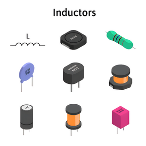

Inductor schematic symbol and common packages (Figure 1)

Inductors are typically identified by the symbol shown in Figure 1 and are usually denoted with the letter L followed by an identifier number. (E.g., L3)
