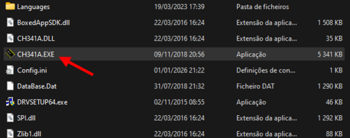

In order to use this device we must first install the drivers for it, the drivers are available here Drivers
After downloading the drivers and installing them you need the software to program to Read/Write to the ROM you can find it here Software
After downloading the file unpack the RAR and run this program.

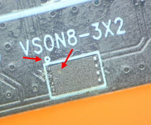

To read the ROM, you must first desolder the old ROM from the iPad/iPhone and solder it onto the programmer.
Keep in mind that you must match Pin 1 correctly. If you solder the IC backwards, you may permanently damage it.

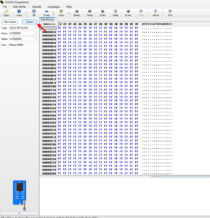

After having the chip soldered, we are ready to connect the programmer to the computer.
Connect the programmer to the computer, and in the software, click Detect. A small window should appear. (If Nothing happens it may be a bad solder connection or a Dead ROM IC)

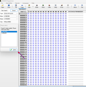

Click on Select
After selecting the chip, a lot of information about it will be displayed. This is a good sign.

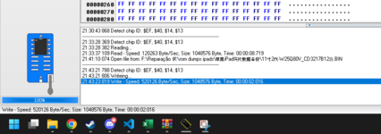

Click Open File and select your file. After the file is loaded, the program will display a message similar to this:
Then Click on Write
After the program finishes writing, which should only take a few seconds, it will show 100%.
