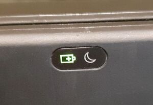

The battery led. (Figure 1)

  1. Plug in the charger. Immediately as the charger is plugged in, the battery led must blink 3 times green, independent of the status of the battery. If the led doesn't blink, it suggests there is a more complex issue with the motherboard, or with the charger, so in that case stop here.
    1. Figure 1 shows the battery led. Note that after it blinks 3 times when the charger is connected, it displays the status of the battery, so it may turn off, or it may turn on with a green or yellow color, or it may continue blinking. Please see your laptop's hardware maintanance manual for more details on the meaning of the led state. All that matters for this guide is that it blinks 3 times when the charger is connected.
