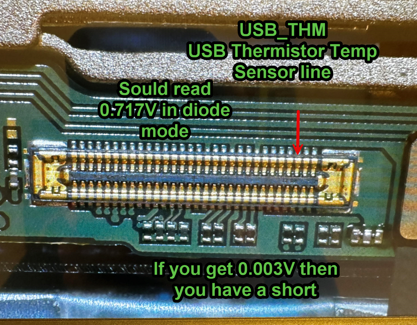

S22 Ultra - The Connector Temp Sensor Line you must check for a short.
