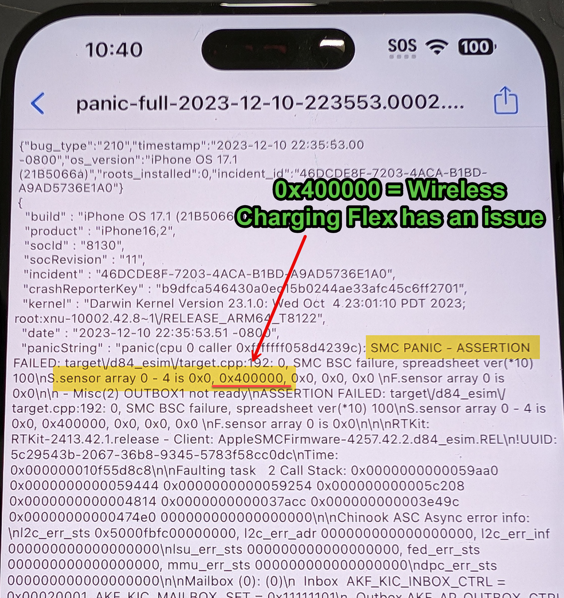

File:Panic Log Example of 0x400000.png
Original file(1,822 × 1,932 pixels, file size: 5.29 MB, MIME type: image/png)
Panic Log Example of 0x400000, which is due to the wireless charging flex being unplugged
