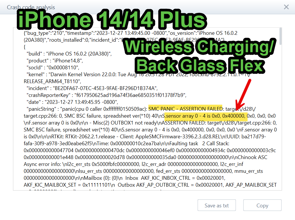

iPhone 14 With Back Glass unplugged. This causes 3 min restart. Panic Log Code 0x400000
