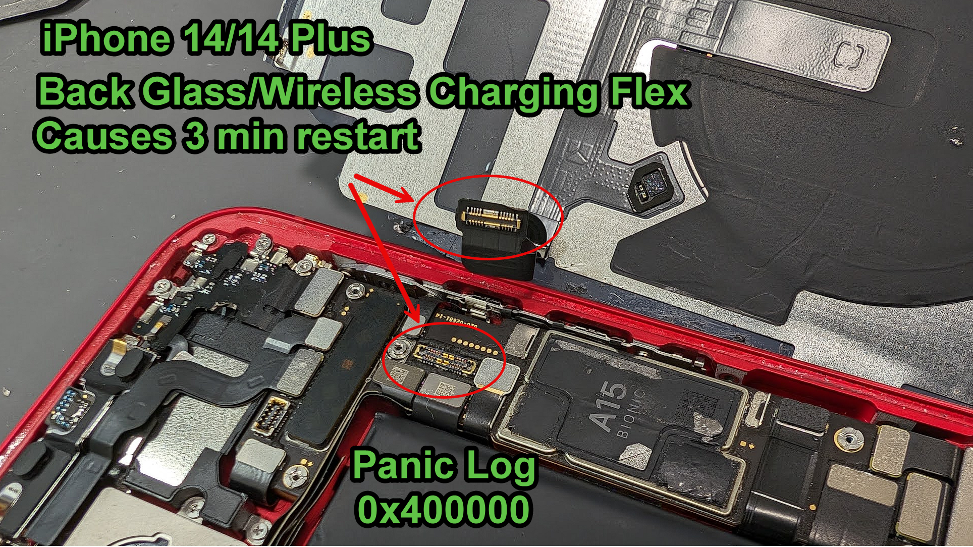

File:IPhone 14 panic log 0x400000.png
Original file(1,928 × 1,084 pixels, file size: 3.76 MB, MIME type: image/png)
iPhone 14 With Back Glass unplugged. This causes 3 min restart. Panic Log Code 0x400000
