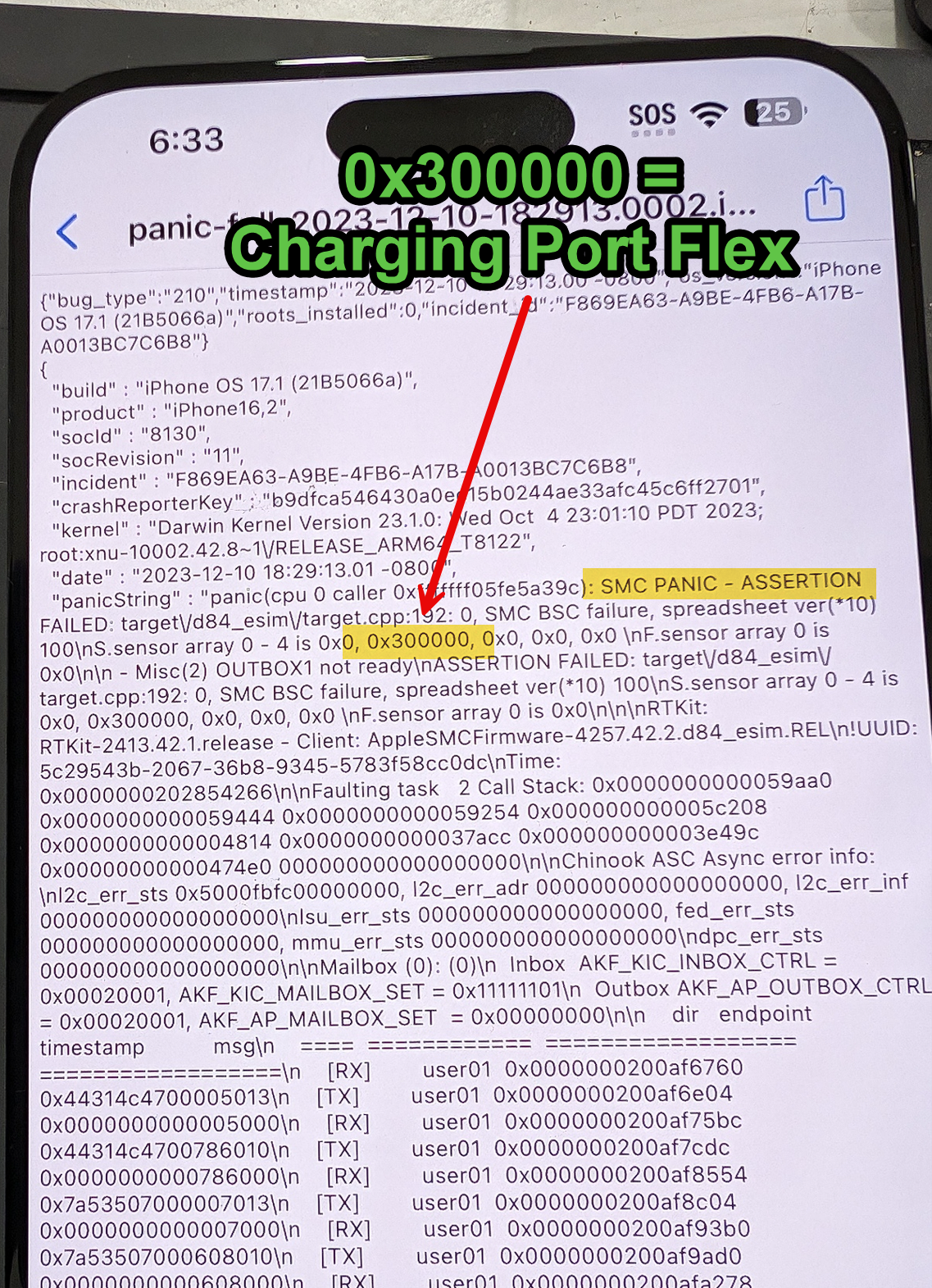

iPhone 15 Pro Max panic log example. It will restart if the charging port flex is unplugged, causing 0x300000 panic log error
