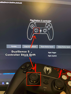

Stick drift is a common issue where the controller’s analog stick registers movement even when you aren’t touching it. This makes characters move on their own, menus scroll by themselves, and generally interferes with gameplay. (See Fig. 1)
Figure 1 -- DualSense 5 Controller Showing Drift in Gamepad Tester Software when the stick is not moved in real life

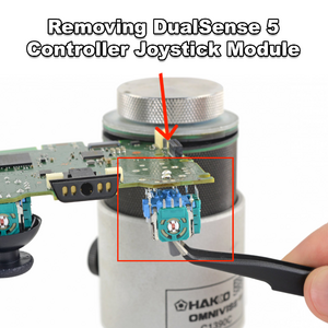

Figure 4 -- Removing DualSense 5 Controller Joystick Module

  1. Confirm the Drift
    • Connect the controller to a PS5 or PC.
    • Leave the analog stick untouched.
    • Observe:
      • Character or cursor movement
      • Axis movement in controller test software
  2. Rule Out Software Causes
    • Reset the controller using the rear reset pin (5–10 seconds).
    • Update controller firmware on PS5.
    • Re-test for drift.
    • If drift persists → hardware fault confirmed.

Repair Option 2: Joystick Module Replacement (Permanent Fix)
  1. Fully disassemble the controller.
  2. Remove battery and internal shields.
  3. Expose the joystick module PCB.
  4. Desolder the joystick module:
    • Add low melt solder to joystick solder points (See Fig. 3)
    • Heat evenly
    • Avoid lifting pads
  5. Clean solder pads thoroughly.
  6. Install a new joystick module (OEM or Hall-effect upgrade).
  7. Solder all anchor and signal pins securely.
  8. Inspect joints under magnification.
  9. Reassemble controller.
  10. Test analog stick response.
✅ This is the recommended long-term fix for stick drift.
