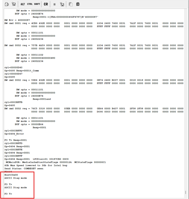

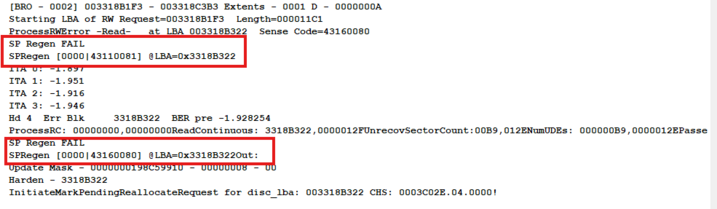

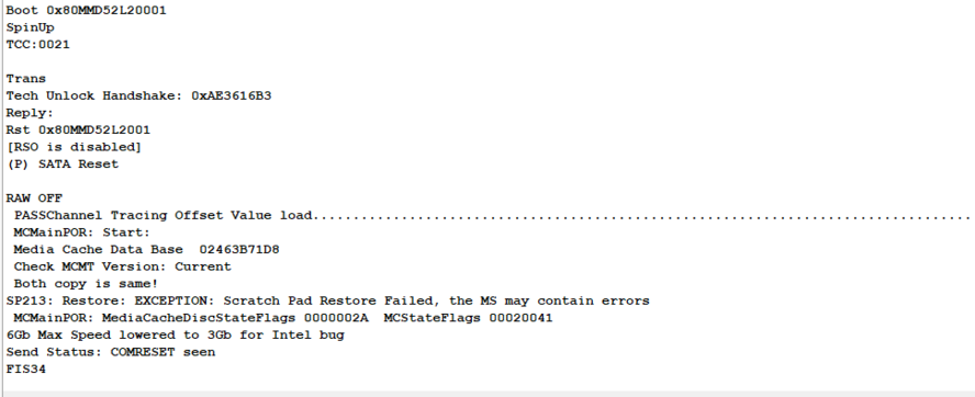

There are several symptoms in the terminal:
1.) MCMT corrupted
2.) SIM Error with 348 in the ID – this is physical damage od the file most likely the file can’t be read
3.) Update Mask
4.) Edac Value
5.) [Scrub Remove]!
6.) SP Regen Fail
7.) Search IDEDC index
8.) Stuck LED + BSY status register
9.) In the Rosewood family DWF issue

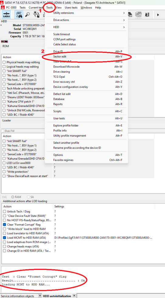

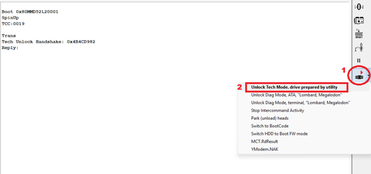

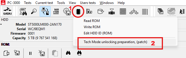

1. Prepare the ROM
2. Unlock the ROM
3. Get the terminal access with pressing CRTL + Z

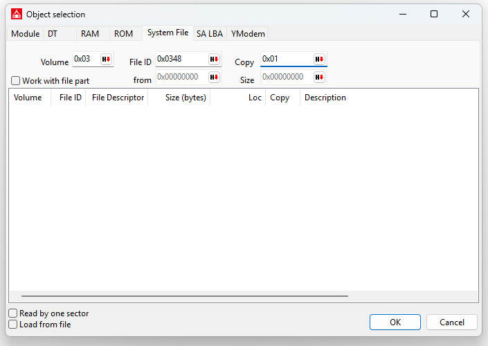

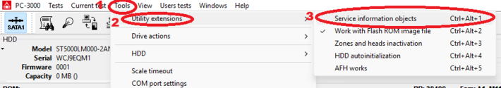

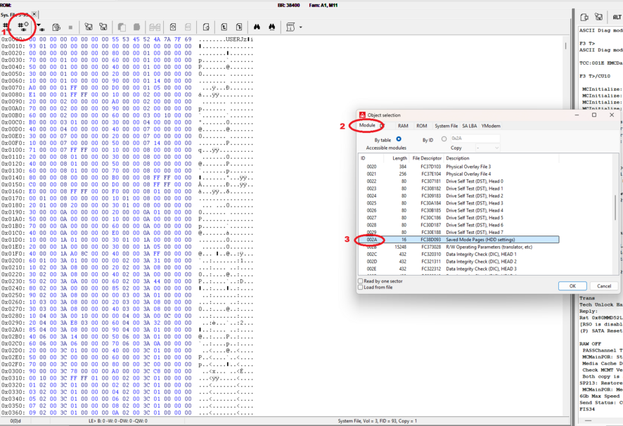

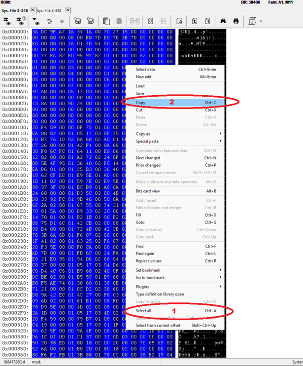

4. Now it is the time to make copies of the most important system files, don’t forget save both copies of those files, it’s very important:

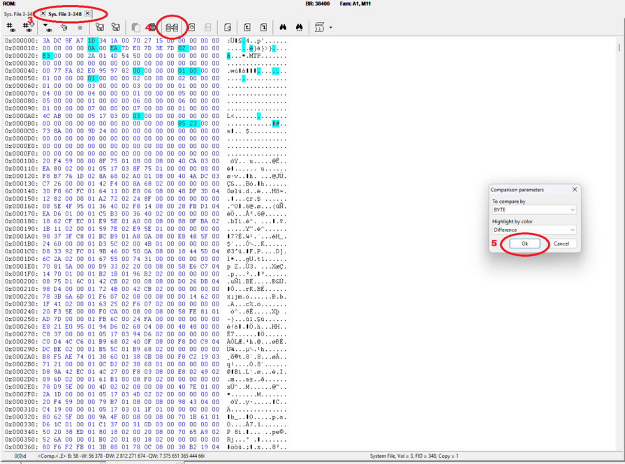

5. Now we need to compere both copies of the file 348.

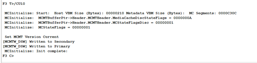

6. It is the time for clear the MCMT by using /CU10 command in the terminal. This command is going to clear the MCMT but we have it’s copies so we can work with them later.

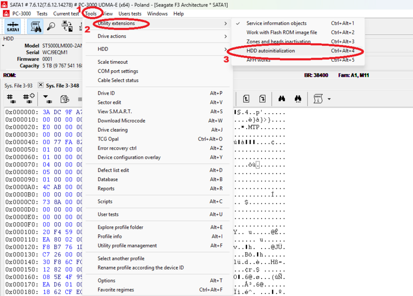

7. Repower the drive and restart the utility if you need
8. Now the drive is stabile and we can make a backup of the HDD resources

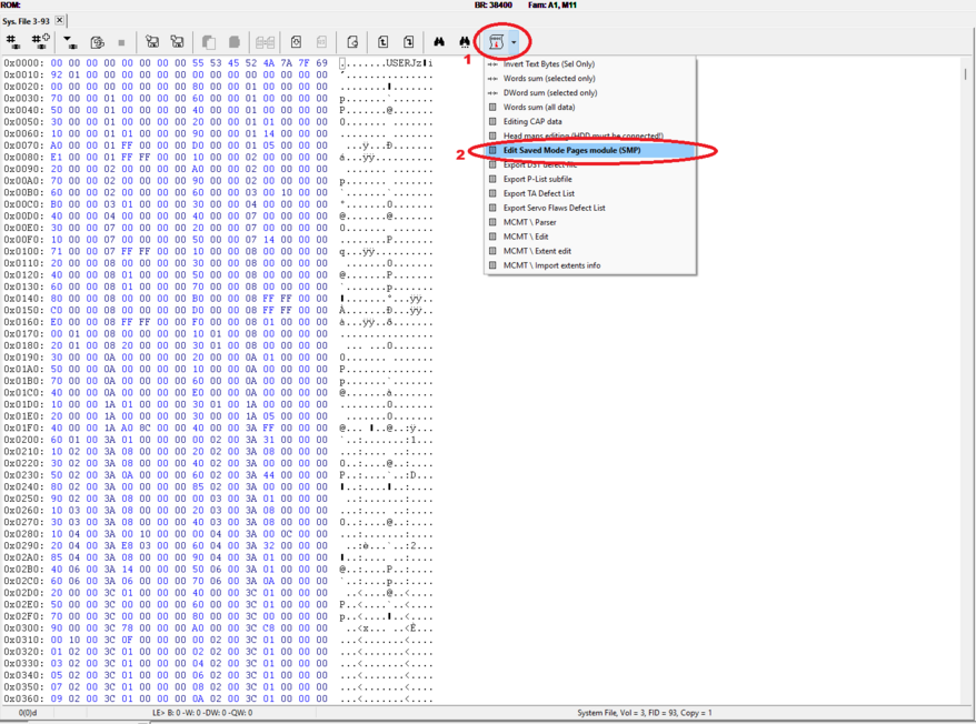

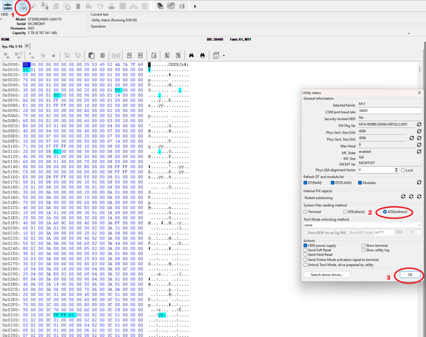

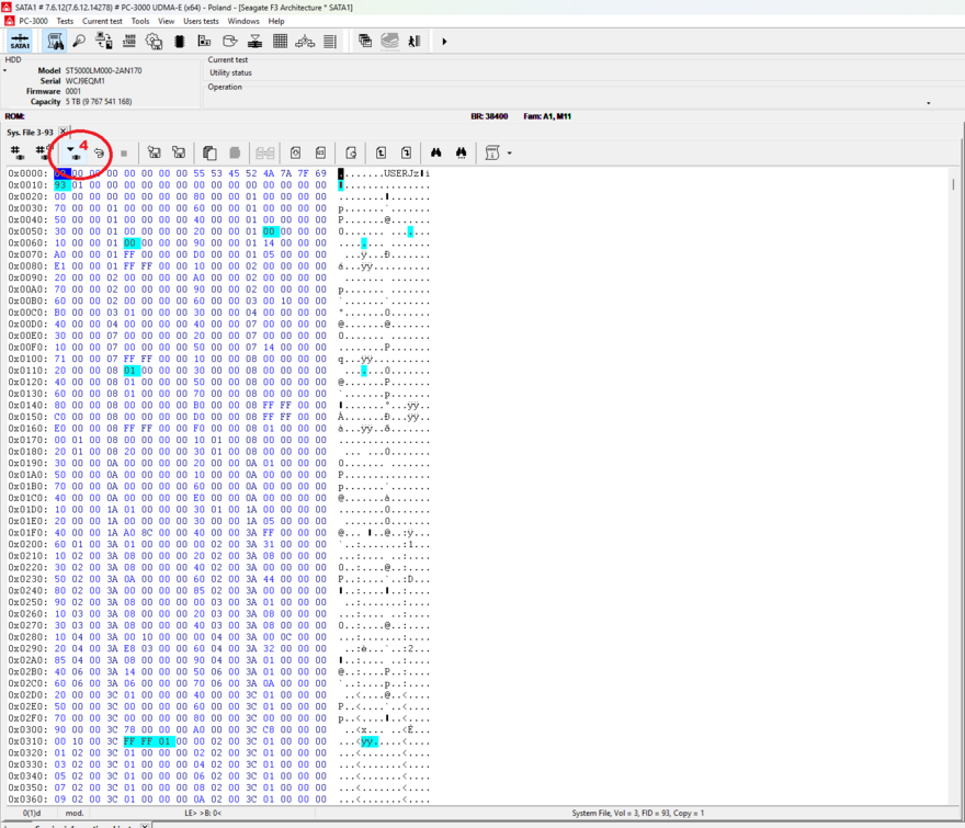

9. In ideal conditions everything should be working and you could proceed to create a task in Data Extractor. But usually drives with corrupted MCMT have a lot of bad sectors so it is a good idea to stop their relocation. We do this by editing the system file 93
10. This file needs to be write in the ATA indirect mode (Seagate Rosewood family)

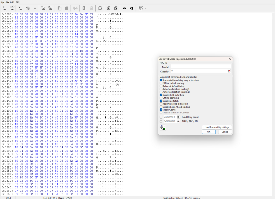

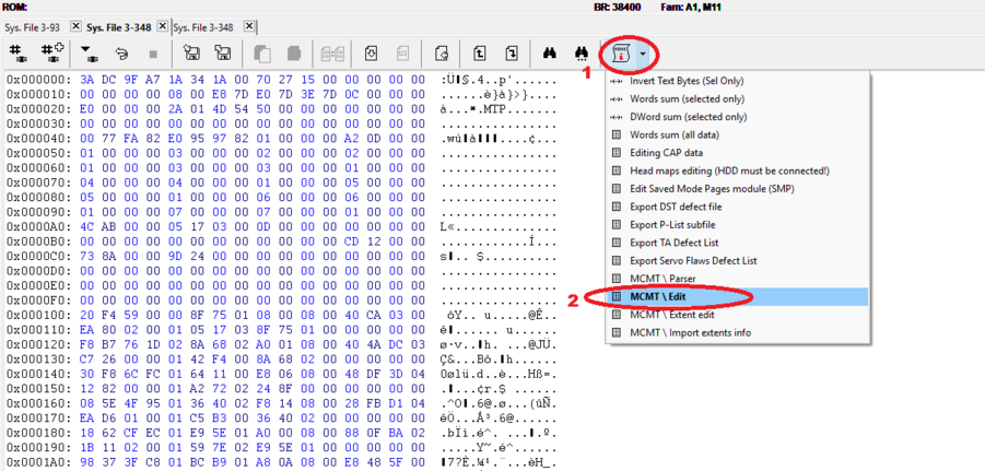

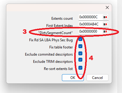

11. Now the drive is ready for the data recovery process but the MCMT is missing and we don’t have the access to the Media Cache where for example part of the MFT table might be located. We need to fix that issue. Lets open our saved copies of the file 348 and use the MCMT \ Edit and MCMT \ Parser options
12. Here we need to fill the “DirtySegmentCount” with 0 and check all the option below that and click OK

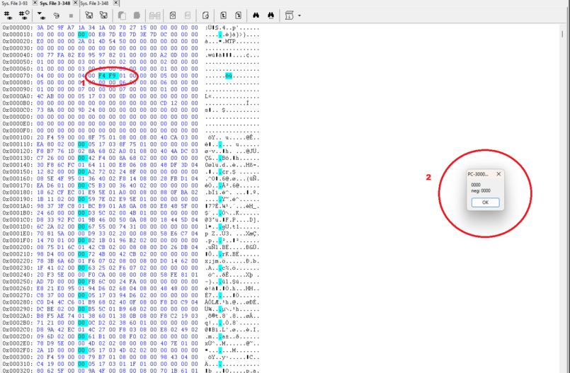

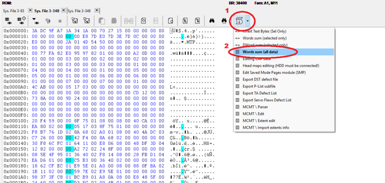

13. After editing the file we need to fix the check sum
14. We look for a place in the file where there are 0000, we change the byte order and check the checksum again

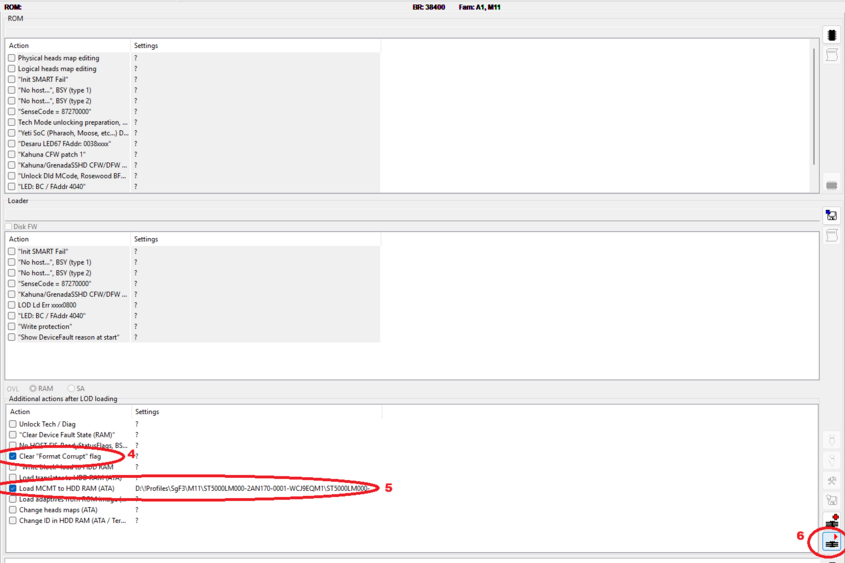

15. We can save the prepared file as module 50 on the drive, but this solution can sometimes be unstable. The best option is to send this file to RAM and then create a task in Data extractor
16. Now we can check if we have access to the data
Now we can go to Data Extractor and create a new task. It would be a good idea to create a scenario so that in the event of a HDD reset, DE itself sends a handshake and sends MCMT to RAM, but this is material for another long article. I hope I managed to explain at least a little what it is and how to remove errors related to MCMT
