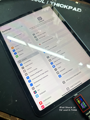

Some iPads using the CD3217 USB-C controller IC can develop a no charge, no boot, or low voltage negotiation issue. This typically happens after liquid damage or a power surge. Replacing the CD3217 alone doesn’t fix the issue, because the connected ROM IC is often corrupted or damaged.
⚠️ Important: The CD3217 and ROM chip are not paired, but the ROM stores crucial firmware/data required for CD3217 functionality. If the CD3217 fails, it often damages the ROM, and a new CD3217 will not function unless the ROM is replaced or programmed.
Symptom 1 (Fig. 1) -- iPad Not charging and stuck at 5.00V and 0.744A

  • Symptom 1 (Figure 1)
    • USB-C power meter shows only 5V — no voltage negotiation (should be 15)

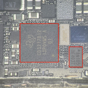

  • Replace both CD3217 and ROM IC (See Fig 2)

  1. Fig. 2 -- The CD3217 IC and the Ace ROM IC
    Visual Inspection
    • Look for signs of corrosion/Look for shorts around the CD3217 and ROM area
    • Check for burnt ROM chips or CD3217

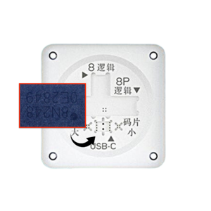

Step 3: Program the ROM Chip
Fig. 3 -- Match the dot on the ROM chip to the triangle on the JCV1S Pro ROM Read/Write Module.
Option A: JC V1S Pro Server
  • Use JC V1S Pro with their ROM Read/Write Module
  • Install and align the ROM chip to the triangle on the programmer. (See Fig. 3)
    • Step 1] Press check on the programmer and it will detect the SPI chip.
    • Step 2] Select 'Open' then 'ServerFile' (Note: Your V1S Pro needs to be connected to WiFi for this to work)
    • Step 3] Choose corresponding file required for the model of your iPad.
    • Step 4] Click Write and Confirm write

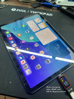

Fig.4 -- iPad Successfully charging after CD3217 and Ace ROM replacement

  • Verify Charging by plugging in a charger that supports 15V charging (See Fig. 4)
